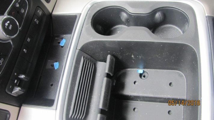

On the right side, you can see the Power Plug, that goes to the cigarette lighter
The 2 screws holes are just to the right of the plug, you can find them under the rubber mat
I think there is a copper colored screw under the larger mat that the cigarette lighter is in, i believe it is a Grounding screw.
after those screws are removed, open the 2 armrest boxes, then grab the rear corners of the console cover & give a jerk up with both hands
see the 3 pieces of blue tape, that is where the screws go
Blue plastic part is the cigarette lighter
