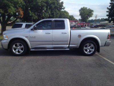

Hi all, first let me pay thanks to all for posting and informing us on the ram 4th gen! Today I am having my bilstein 5100s set at 2.1 with new zone uca, rear bils with super coil Ssc-50 rear coils 450lbs load increase and 3/4 lift, and the zone 1.5" body lift. I am also installing mgp caliper covers in blk with the ram and ram head logo on front and rear. before winter I also want to be purchasing new rims (chrome or 2 tone blk and machined) leaning toward the chrome for my rig and new 35x12.50x20 tires...I am really interested in the new nitto exo grappler, toyo mt, or the trail grappler, for that 4x4 look. Here is a pic of my truck as it sits now. I will post pics of the install when I pick up on Weds. I am really lookin forward to install as I have been collecting all the selected items as I have over viewed and read over the past 6 months. Now it's finally time to install all at once. My local ram dealers bodyshop is installing for me so I will not be hassled by dealer regarding my 7/70000 warranty. Anyone have any ideas on rims I have been lookin over all the XDs, moto metal, etc hard to decide, I am old school so I think all chrome will really look good with the chrome and silver on the truck, but I do also like the 2 tone as well. Any ideas will be appreciated, Also thanks to Bully's Performance for the gr8 deals on my mods, they are super to work with.

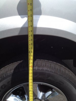

Here is the front measurement. Roughly 36.5

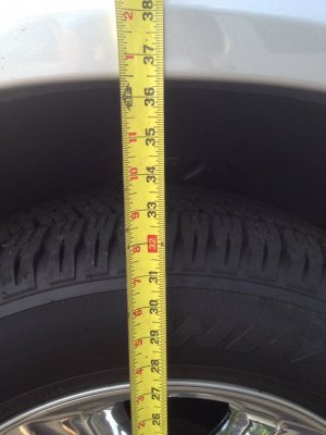

The rear measurement. Sorry for all the post but I can only post 1 pic at a time.
Roughly 38.5"

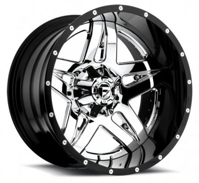

I've been narrowing down rim choices and really like the fuel full blown 2 tone chrome and black, pic below. Question is can I fit a 20x10 rim on my truck with bils at 2.1 and 1.5 BL with 35x12.50x20 nitto trial grappler. These rims have a -19 offset and only seem to come in this size. I have the stock flares but will the tires hang out too much and or rub?

Those are nice. If I wouldn't have gotten a black express I would have been all over those

Yea I like those wheels as well.. I have similar likes in wheels being that I have a silver truck with the chrome accents, even though I love the silver with black look, I want to go chrome as well. Those seem to be a good mix of both. Looking forward to watching your progress

Thanks guys, my question is do you think they will fit if I set bils at 2.1 and 1.5 BL and zone Ucas? I could set the bils to 2.8 but I was hesitant to max them. These rims only come in 20x10 with a -19 offset, not sure I can clear them with 35x12.50x20 trail grapplers. Any one have any ideas? I do have factory flares and gatorback mudflaps on that will help cover up some of the tire, but not sure if it will be too much offset, don't want too much kick up onto the rear quarters. Thanks for chiming in I do too really like the two tone with chrome not machine and blk. I originally was going all chrome as I think will pop better than the blkout on my rig. Any other thoughts?

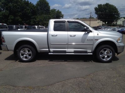

As promised here are the pics of my leveled and lifted 13 Ram Big Horn. I will have to post pics one by one as I cannot seem to attach more than 1 at a time. Enjoy! Loving the look!

Before front fender from ground up approx 36.5 after bilsteins set at 2.1 and 1.5" zone BL sits at 40.5, should settle a tad bit.

Factory height before was 38.5 pics above, Rear after zone 1.5" BL, bilsteins and super coil Ssc-50 coils with 450lb load increase and 3/4" longer sits approx 41" and much stiffer.

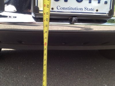

Front clearance height, I can now crawl right underneath.

Sent you an email.
We can do em in -12 or -24 as well.
I'd say, rock the 20x10, -12 offset as you'll get a better lip
It will stick out 1.5-1.75" past the flares which doesn't look bad on a lifted ram
