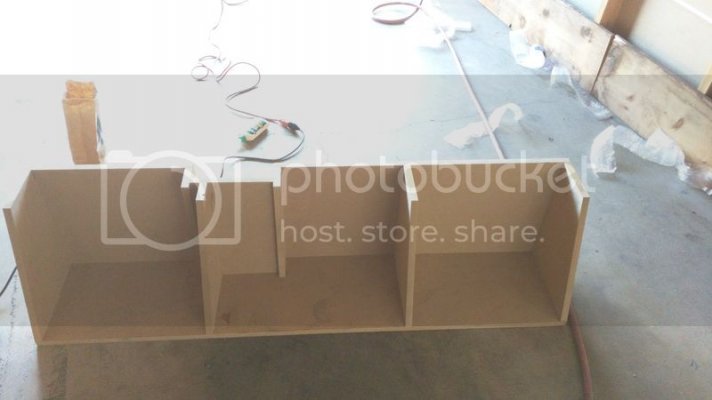

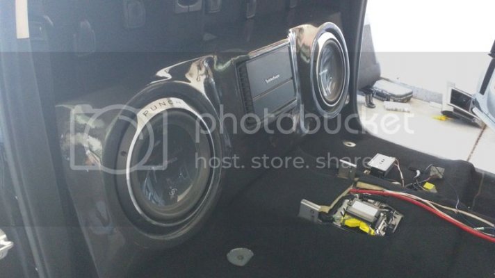

I decided to add a set of sub-woofers to the R/T i used Audiocontrol Lc2i and tapped the front speakers at the factory amplifier under the dash. Some songs have an overwhelming amount of bass and sound great white other tracks that normally would have decnt bass sound flat and i can hear vocals coming trough the sub-woofers. Will replacing the Lc2i with something like JL audios cleansweep help??
Equipment:
(1) Rockford Fosgate P1000x1bd mono amp.
(2) Rockford Fosgate 12" 4 ohm P3 subwoofers wired for 1 ohm load
(1) Audiocontrol Lc2i

your box tuned out nice!
as for the hook ups.. is your factory head the alpine? i havent played with the alpine in my new truck, but a few years ago i had an '11 durango and it had the alpine in it. i have better success for sound to tap into the factory sub for the signal into a LOC. at that time i was just using a basic 4channel LOC from wally world also.

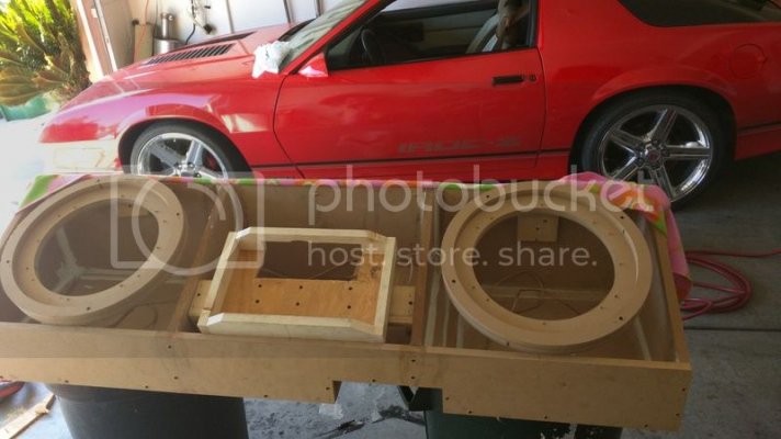

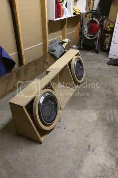

Great looking setup how much air space did you get per sub?
I am getting 1.21 cu ft per chamber, I looked up the specs and per the manufacturer they suggest 0.75 - 1.25 range of cu ft for sealed enclosures so I am pretty happy about the results.

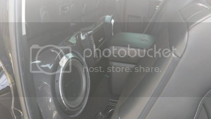

Looks sweet, can you post a pic with the seats in too... I'm looking for box designs and ideas for my R/T but thinking of wrapping it in stitched leather to match the seats and dash.
I have been considering getting the box wrapped in black vinyl with silver stitching to match the seats, the only reason i went with paint was cause I had the material left over.

Very nice looking box. Don't put vinyl over that thing.
