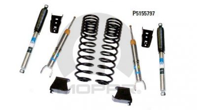

So what's the consensus on this subject? The mopar 2" lift using the Bilstein struts to the 2.8" setting with rear spring and shocks and bump stop extensions. That's it.

This is the picture from the Mopar website

how much lift do the rear coils provide?
