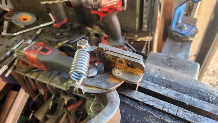

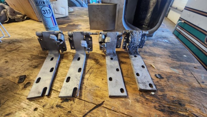

Starting to work on the Cab soon, the hinges are pretty rough so I went over to my buddy's place and sandblasted them. will try to figure out how to fix them tomorrow.
Heather housing cleaned up well

Your gettin there...keep at it...maybe another 100mg will help...ha!
Heck...those hinges will buff out just fine...lmao

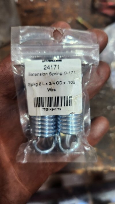

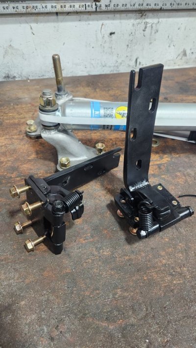

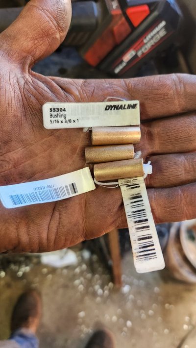

Spent today figuring out my door hindges, was able to match up the springs , and found bushings.
Tommorow should be pretty easy now that I have my master plan :waytogo: :birgits_tiredcoffee
To bad my 3/8 reamer won't be here until Tuesday for aligning those bushings.

An old trick to add life to a bushing is heat it up in the oven to 350 or 375,then throw them in a bucket of oil to quench them.My Dad always used 50 weight,but even a 30 weight oil works good for oil impreganting them

All I have is Red Line 5W30 :driver:
But will definitely be doing that, thanks for that tip :favorites13:

Price of Redline these days,i'd make a trip over to Crappy Tire /Napa etc,and grab a litre of cheap 30 weight,lol

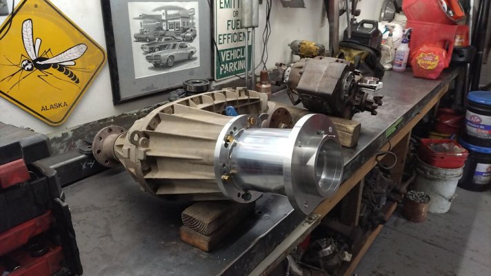

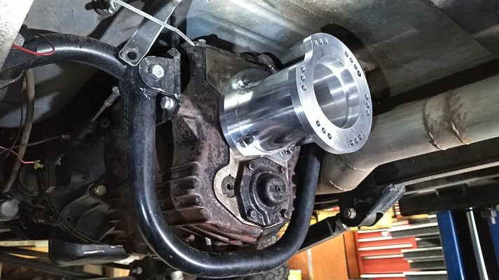

This is interesting :dogpile:
Cummins guys sure love these Eaton Swaps. I mean Dodge cant build anything thats reliable... LBH...
I shouldn't need this, as Im sure I have enough room for the Divorced T-case setup. But if I dont its nice to see someone already designed one.

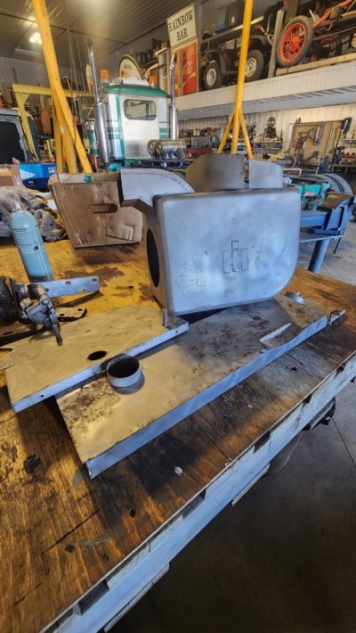

New Tractor intake on eBay :favorites37: , this is a must to run a P-Pump
