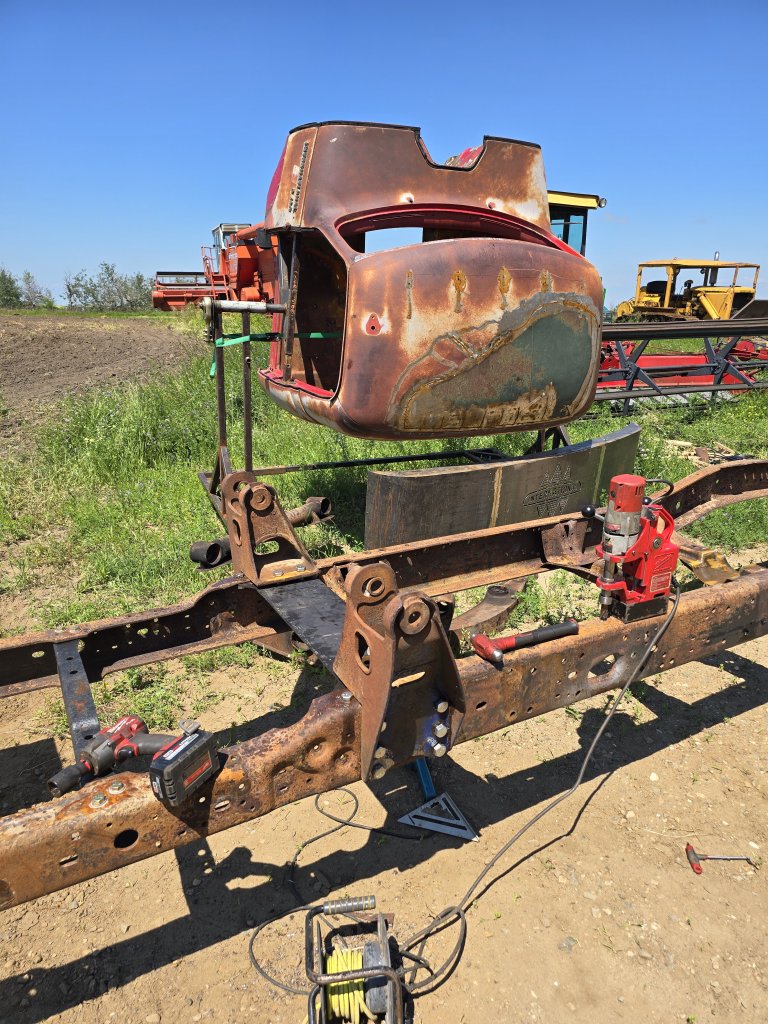

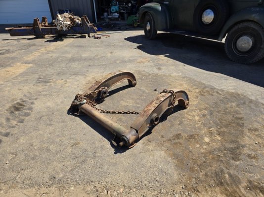

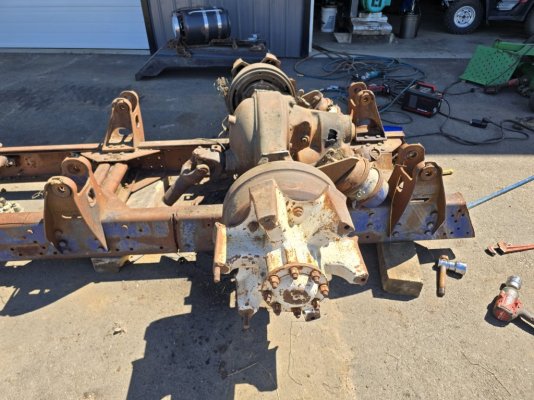

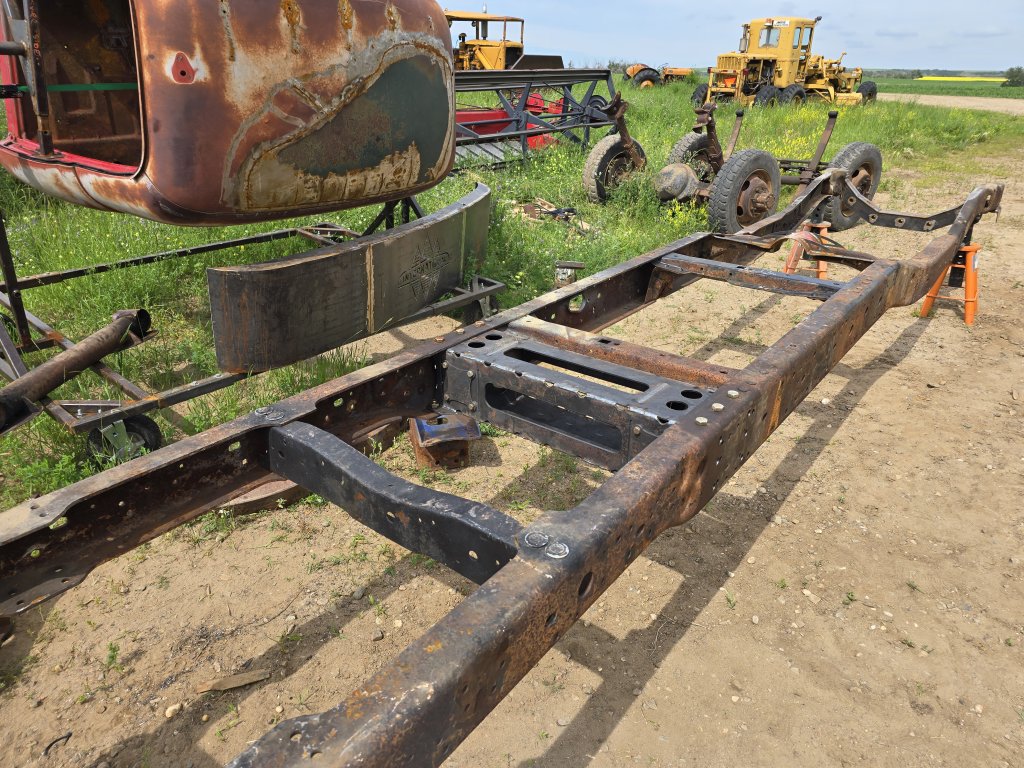

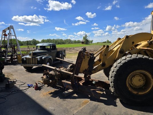

Look what I found in the scrap pile :headbang: ;) :cool: :evillol:
This rear air ride on my F550 frame is the exact amount of zero Phucks given one must have to build rat rods.
Yardbird
Aug 6, 2022
1,163
2,711
Western NC
3.6
That Neway suspension was good in its day. Beat the heck out of Hendrickson short leaf suspension. I remember the first one I saw on a truck. A red International 4070A, down in the Texas valley area in 1976.
I asked the driver about it, then we talked a while about trucking. Truck drivers would talk to each other in those days......

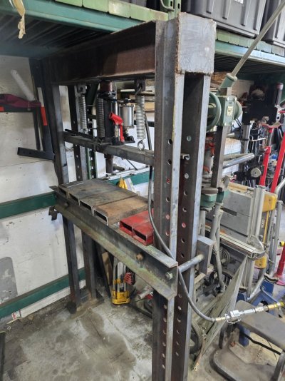

I bent the top beam of my press today. But out is out. Even torched out the inner price beforehand :headbang:
View attachment 586422View attachment 586423View attachment 586427View attachment 586428
Sawzall or torch and cut a notch in the outer shell,pretty common way to remove bearings/bushings.
If you're good with a torch you can notch the shell with-out hurting the cage it sits in,if your torch skills aren't that good a sawzall with a good quality blade is a good substitute

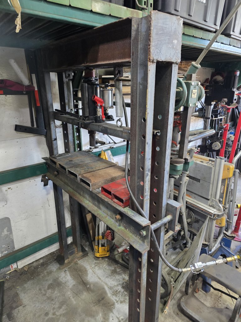

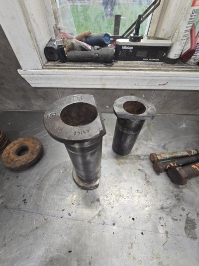

I didn't want to damage those sleves and pins in my last picture. Its like 200$ for a new set .:cool:
The fact my press broke shows me I built it wrong. So it will get upgraded now. :evillol:
Sawzall a semi truck bushing, WTF are you smoking it's 7" of 1/4 harden steel for the axle pivot point.... LoL... :crazy:
Like I said I torched it out first, finding the weak spot in my press design was just a bonus! :headbang:

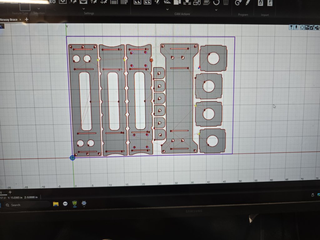

This is the new one , all cut on the plasma ;) spend 400 to save 200 best guy math ever.

You need to learn to use a torch then,if you don't have the patience for a sawzall :Big Laugh: :Big Laugh: :Big Laugh: Hell it's pretty common to cut them out with a torch,bushings have been replaced at -40 on the side of the road:Big Laugh:
Even if you're a bit shaky with a torch and do cut a small notch in the housing,it's not gonna hurt a damn thing,as the housing only holds the bushing,quit being a chicken $h!t :Big Laugh:

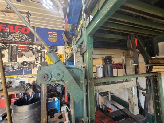

Easy day, My buddy gave me a press he had in is scrap pile. And fitted the Neway mounts.
