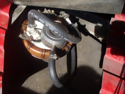

here is pic of install maybe I did wrong HELP

Why on earth would you cut a hole in the bed floor just to replace a fuel pump or filter!?!?!

Casue I watch a video on u tube

There is a lot of stupid stuff on youtube, but that doesn't mean you should do it!
