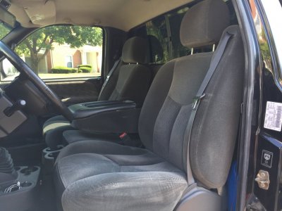

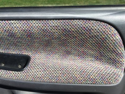

I'll let you in on a little secret, it doesn't matter what seats you swap into your Ram its all about comfort! Anything, and I mean anything is better than the old seat of a 2nd gen. I have personally had this setup in my truck since 2004, and it feels about as good as the day I installed it. What I have is a 40/20/40 bench seat from a 2003-2007 Chevy standard cab pickup. It matches the color of the interior and the inserts are pretty damn close to the door panels. These have all kinds of variations including cloth, leather, combo and power/manual controls. Whatever you use plan on building your own seat brackets as this can vary widely, mine were 2" angle iron welded up as needed. I'm a tall guy 6'2" and set this up so I could stretch out my legs on long highway commutes. A person 6'6" could drive this truck no problem with the amount of leg room I have. That is one pet peeve I have with seat swaps, the seat is set so far forward it compromises other driving needs. These were great cause the seat belt is located in the shoulder, a bonus if your installing this into an extended cab. Oh, yeah....5 cup holders, nuff said!

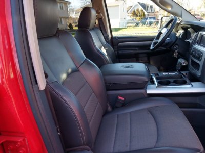

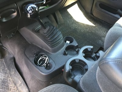

4th to 3rd gen bolt in (seats, console not so much; that takes some work lol)
