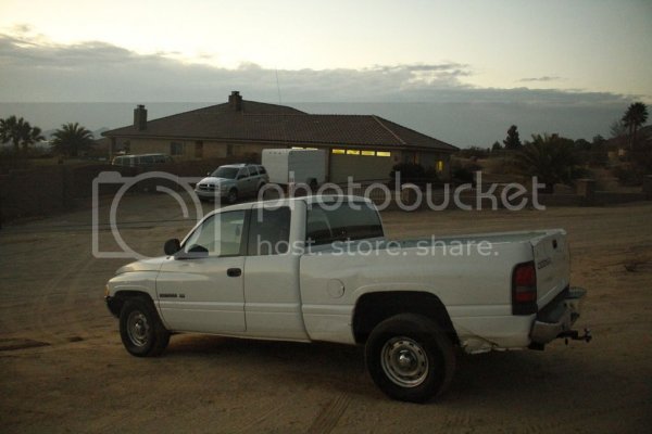

Not sure if I can make a build thread here but here's a copy of my introduction post. Hello my name's Luke and I'm from Sunny SoCal =) I traded a 1991 Honda Accord for my 1998 Ram 1500 2wd Extended Cab. Compared to the Honda it's like driving a brand new vehicle! There isn't one thing wrong with the truck mechanically. It's got 180,668 miles on it. I'm not really sure what maintenance I should preform other then the standard oil change and filters. I haven't found a list of preventative maintenance on here yet. Alright now for some pics.
Here she is the day I got her.

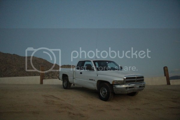

This is her a few days ago after I fixed the dents on the drivers side and installed my CB

Looks like it's been a work truck. What are your plans for it?
