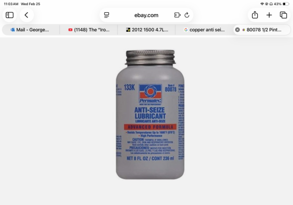

In a previous thread I read the recommendation to “blow out” the spark plug well when replacing spark plugs. I like that but want to clarify it for anyone unfamiliar:
When first unscreweing the old plug…. only unscrew it partially…then use compressed air to “blow out” any debris in the spark plug well/socket….Before removing the plug completely. (Otherwise you may blow debris Into the cylinder.)
Also, put a little anti-sieze on the Middle Threads of the new plug before installation. This will facilitate installation, future removal, and improve electrical and thermal conductivity of the new plug. The middle threads so as to avoid getting any onto the electrodes.
Hope this helps.
This is a product I keep in the shop for such:
