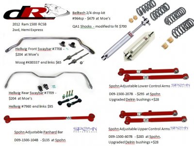

2012 RCSB
Cab configuration: RCSB
2wd or 4wd: 2wd
Brand of drop kit: Belltech 964sp, Street Performance shocks, Hellwig swaybars front and back, Spohn adj. panhard bar, Spohn adj upper and lower control arms
Wobble: None
Actually, my set-up has changed...
