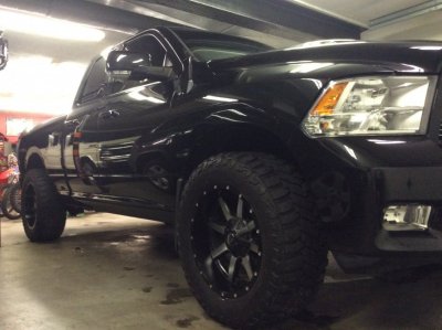

I have 2011 sport and installed 2.5 hell bent steel kit and still have a little rake. Is there some way I could get another inch without installing a lift? I have 20x12 fuels with -44 offset and 35x12.50x20s and still have a little rub upfront

You need bills set at 2.8 if you dont want rake. Leveling kits won't do it.

I have 2.5 spacers up front with .75 spacers in the rear. Sits level. Bils not required [emoji12]

You can't stack another spacer in with the 2.5 level. Bils are gonna give you that same aproximate height. Rake is different from truck to truck, so not everyone levels the same. Trimming or adding a lift are probably you're options. But, others are sure to chime in.

Pulling out the leveling spacers and installing Bilsteins at 2.8" will be your best option. As others said, you can't stack spacers.
Also, your wheels sure look like 10 wides to me, not 12 wides. 12 wides with 35x12.5's would not be fitting on your truck with only a leveling kit.
