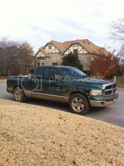

2003
photo.php
by the way i think my leafs spring are arched the opposite way alittle cause i ran for two weeks with just a helper and main spring so its lower than most that just put shackles and remove helpers. heres a pic.. hell the pic might work its off my facebook so who knows
Redtruck-VA
Jun 29, 2010
5,864
985
Virginia
2003 & 1989 D250 RWD
Hemi-5.7, 5.9 12v & 24v diesel
I was gonna get some reflexes cause i heard they were stiffer than most but i guess ill go up to advanced and see what they say thanks though for yalls suggestions but im still worried about hitting the frame if i get rid of the bumpstops
Use shorter after market bumps or Tembren rubber springs.
J
justadodgeman
Aug 13, 2013
167
14
west virginia
2003
thanks man ill get new shocks and try to cut the bumpstops shorter and if that doesnt work then ill get the tembren ones
