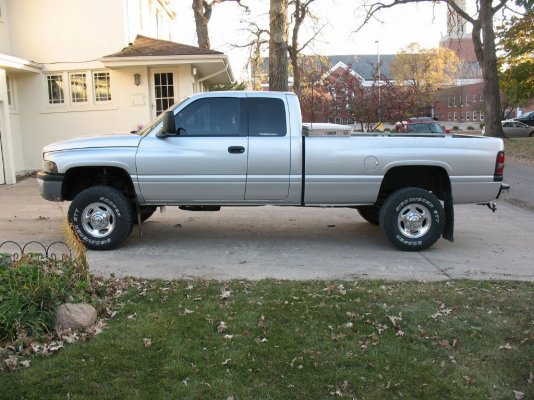

hmmmm....you think going up to a 3" front level would help matters any? heres a current pic of how it sits with 2" level

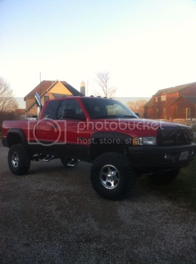

This might give you a idea on the room .. Mine has a 5" on 35's

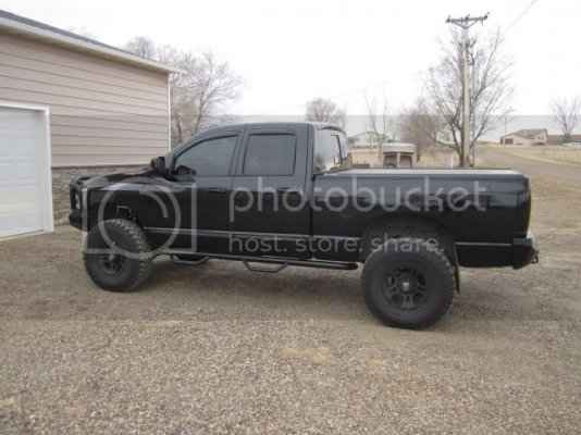

Yep , and same truck as yours
