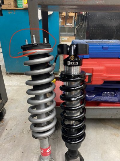

If you go the bilstein route, you get just shock absorbers and then have to disassemble your OEM setup to take the spring, and spring perch from that to transfer to the new bilstein shocks. The top hat is the assembly that holds the spring onto the shock from the top side and allows you to install the entire strut as one piece back into the truck. I believe it has some rubber isolators and a metal plate as well as the bolts that secure the shock to the truck and the rubber isolators get worn down over time and taking them off to reuse from an old truck is just asking for noises or other problems down the road so with as cheap as they are it saves a lot of future headache to buy new ones.
Here is the item from tire rack
It’s the red circled area in this picture which are from the lifted struts I just took off of my truck to be replaced with the icon coilovers next to them
