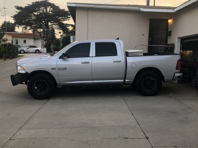

hey guys. 2014 ram 1500 4x4 hemi. Has 35x12.5x20” tires and aftermarket rims. Not sure of back spacing. I have a fabfours front bumper. Currently no rubbing at all. I believe I have zero lift right now. This is how I bought the truck
I have about 2k to spend. I would like around 4-6 inches of lift. Was leaning toward the Rough country 4 or 6.
I will be installing this by myself in the driveway. My concerns are that I drive this truck to work Monday-Friday. I can start the disassembly on a Friday evening after work. Realistically when will this be completed and will I need anything other than what’s in the lift kit? I know I’ll need an alignment which is sort of a problem as a shop won’t be open on Sunday to get it done. I assume atleast all day Saturday and part of Sunday to have the lift completely installed.
if you guys had 2k to spend on lifting your truck what would you do and what are your thoughts on doing it yourself, anything extra needed, etc...?
Picture is how she sits currently

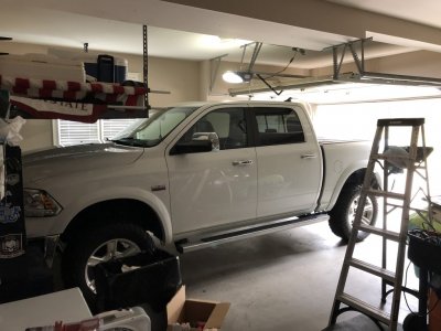

If you utilize your garage, I believe a 4” lift on 35’s will allow you to squeeze into a standard garage. I may be wrong, but I recall other people posting about it.
Your are correct sir, my truck still fits in the garage (excuse the mess, that was taken over the Christmas holiday).
