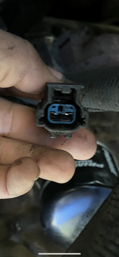

As a dealership tech for over 20 years I have seen this issue over and over. There is one weird thing you can try to make it stop. If you look at the oil pressure switch connector you will see two wire terminal holes but only one wire. In the side without a wire is normally a plastic pin to fill the hole. Remove the plastic pin with a small screwdriver and reconnect the connector and start the engine. I bet it has normal oil pressure after removing the plastic pin. I have done it to every motor from the 2.0 up to the 8.3. Give it a shot.

I will take a closer look at the wire, but I believe there are two wires on the connector side.
Nothing would surprise me though.
I have seen instances with electronics where a generic part will work, but not long, as the OE part is bastardized just a bit.
After looking at the wiring diagram your truck only has one wire in the oil pressure sensor connector like most others. Remove the plastic pin from the other slot and reconnect.

Two wires on mine
