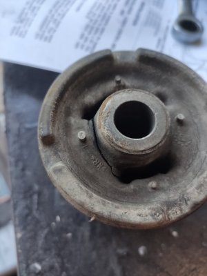

Everything came apart pretty easily, I'm very thankful for that! Naturally my ball joint press isn't quite big enough to press the new ones in, so now I get to wait on the Miller 8682 to suck the new parts back in.

Yes, this is a hefty tool! It struggled a little to press the new bushing into the control arm, but it was no problem to do the one in the chassis. When I do the second one, I may do some quick sanding on the control arm to open up the hole a thousandth of an inch or so to make the process a little easier.
That wasn't doing me any favors. I'll have to work up the motivation to do the other side, I'm sure it's just as bad.

Put some grease on the threads of the tool, also a thin coat around bushing. an air impact also helps.

Yeah, I put a lot of penetrating oil on the bushing sleeves and greased up the threads. Things seemed a lot easier just using a box end wrench and my breaker bar to do the pressing.
