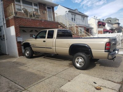

Hey everyone just bought a new (to me) dodge and its my first one. 51k miles married to a automatic trans. Personally I cant stand a automatic and am looking at doing a swap for a standard. can anyone tell me how to go about identifying which transmission I have? I understand that the 2500/3500 in that year was out of place because it was changing to 3rd gen so im a little confused as to what trans I need to actually start looking for. any help will be much appreciated.
