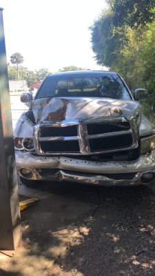

Front of donor truck picture ...sounds like it be easier to just use my good truck with bad 4.7 engine to convert the donor to a 4x4, transfer all body parts and get it painted...I was going to paint it afterwards anyways. So basically swap donors lol

Which truck has the better interior?
How about the condition of the instrument panel?
Which frame and diff's have the least amount of miles on them?
Do you absolutely want or have to have 4WD?
I'd keep the 2WD HEMI truck together and put the good body parts on it from the 4.7 truck and then later on if you wanted to then swap the 4WD parts over. That way you can get up and rolling as fast as possible.
