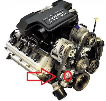

The spacers clear the temp sensor and the brackets relocate the accessories for the throttle body, but I could use 09+ car style timing cover instead of brackets right? Then I have room for TB and the spacers clear the temp sensor? I also want to remove the clutch fan and replace with e fan, make some room under the hood and clean it up a bit.

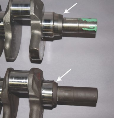

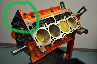

No you can't. You're not getting this, nothing outside the heads (with exhaust manifolds) and intake manifold from an eagle engine can be used on a pre-eagle. You literally CANNOT bolt an 09+ timing cover to an 03-08 block. The 09+ timing cover is designed for the extra girth on the front of the block housing all the VVT hardware, not to mention won't line up. The damper won't bolt to the crank and nothing will line up. The short block is quite literally a different engine.
pre-eagle (6.1 is the same way):
Eagle/Apache/Hellcat
Temp sensor boss was moved to make room for the VVT solenoid as well as providing room for the front of the manifold. Here is the crank snout difference, this doesn't include the different tone wheel it uses.

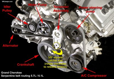

You COULD use an 05-08 LX timing cover, but that would require you to totally rearrange your accessory drive and route extra wiring and A/C hoses as well as reroute your radiator hoses, as the inlet/outlet are different. This would give you TB clearance (as long as you converted to an electric fan) but you'd still need the spacers or you can take your chances trying to heat up the front of the manifold and push it in far enough; you run the risk of ******* up the manifold doing that though. This is how different those two accessory drives are, it's been done but you have to decide if it's worth it:
Some 3rd gen frames have clearance issues with the A/C compressor. Chrisp2493 did it and didn't seem to have any issues with frame clearance on his 03. Optionally you could use a 6.1 intake manifold (this is what the clearance brackets were originally conceived for since that was the only available upgrade back in the day) since it is taller and you wouldn't need the spacers.
