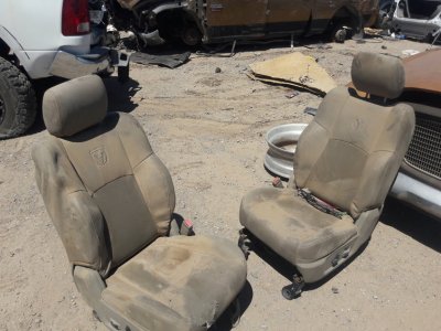

New here. I have an 03 ram that I've been upgrading over time. I have an 07 front end and just weeks ago I personally installed the whole dashboard from frame to plastics from an 08 since my original was real bad. I recently purchased seats from a 2015 Laramie at a local junkyard for $100 for the pair. One was a little damaged but has been fixed. I need help connecting them. Both are powered and my originals only the driver side was powered. I need electrical help if anyone has done this before, thanks.

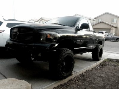

Sorry no one has helped out yet. Awesome looking truck you got there, looks like you put a lot of hard work into!
I don't have any personal experience with the power seat wiring, but I've done some wiring before. You said you have power to hook up the seats on the driver side? Did you get that seat working? If so, I would suggest just splicing on new wires from the drivers side harness, routing them under the center seat and connect it up to the wires on the passenger seat. If you are looking for what wires you need to use, the service manual will have the wire diagrams and pinout for the harness. Hope this helps!

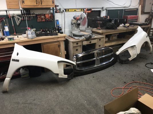

so later 3rd gen model head lights fit the 03? what about the tail lights?
The 06-08 headlights will work on the truck, but you need the fenders, grill, headlights and the bumper cap. The 03 headlights have the wavy bottom, and the 06 up has the flat bottom lights.
That’s all the stuff I’m using to do my swap in a few weeks

Real curious what you used to clean those seats

I jury rigged the srt seats I installed just get power to operate the tracks. I need to find the plugs. They seem to change a good from model to model.
HemiLonestar
Navy Badge Coast Guard
Jun 1, 2012
6,816
4,690
MD
One seat swap I did the driver's plug was hidden under the carpet, just had to tap off the that harness to run to the passenger side.
