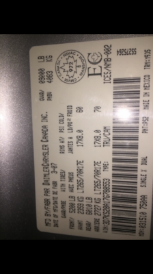

Here’s the ad for the donor truck and pic of the vin I just don’t want to invest loot then it doesn’t fire up , eBay can ship one same truck same year same vin for 1950$ or I can go rip this one out for 900$

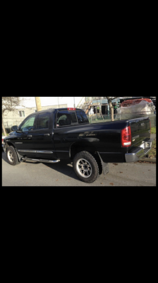

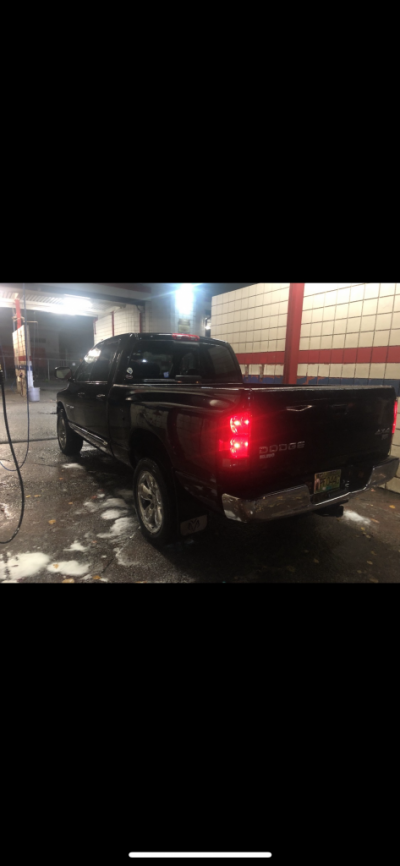

First wash after 7 years sitting in my back yard OBX exhaust headers installed
