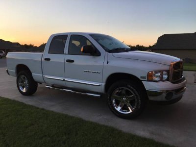

When I bought my truck about 4 months ago it had the 6 inch RD lift installed already. I knew nothing about lift kits at that time. Rides good but rough it think (nothing to compare it to). i like the looks and hope to get it out on some trails this summer here in Colorado. This is what it looks like

I have Rancho shocks on it now(came that way). I wonder if changing them out would give it a better ride. Any recommendations?
