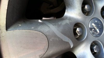

Thanks for all the replies. I know the front brakes supply most of the stopping power, but it seems as if I raised the rear wheels and tried to stop them in drive they wouldn't even slow down. I'm going to test that Monday or Tuesday when I get time.
This is a picture of my drivers front wheel after a few days of driving, covered in brake dust. I'm not stomping on the brakes or doing any city driving. My rear wheels still look clean.
I think my fix for the dust is going to be new pads and rotors as suggested, but still concerned that my actual issue something else.
