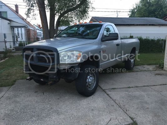

So I figured I'd start a build thread for my truck. I got the chance to off road in some Jeeps recently and fell in love with being out on the trails. My Jeep was (is) a lease, so I wasn't able to really push the limits or modify it at all which made me start looking for a rig to build. After talking to some of my Jeeping friends about buying jeeps, modifying, etc, I realized that some of the most important upgrades people did was heavy duty axles and drive train to handle big tires. So instead of buying a Jeep and upgrading to tons, I figured I'd just buy a heavy duty truck.
Using that thought, I found myself with a new truck:
It's a 2008 Ram 2500, regular cab, long bed, 4x4, auto with the 5.7l hemi. I wanted the solid axles, v8 with as little weight as possible.

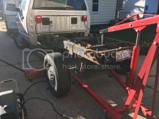

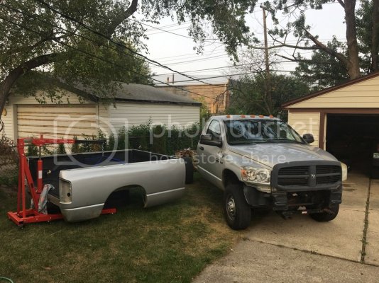

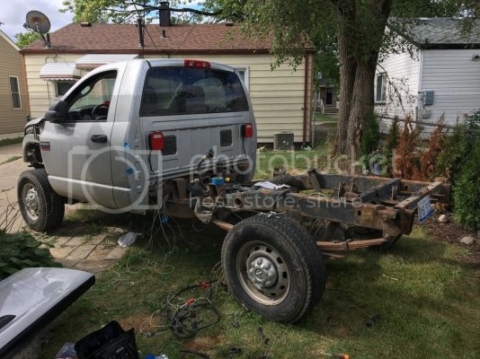

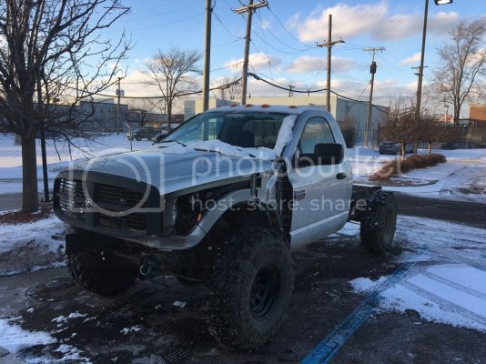

So first step was to remove as much weight and save the good body panels. Here are a few pictures of the process:
Then I chopped the frame rearward of the rear leaf shackle:
Before:
After including a temporary tail light mounting solution:

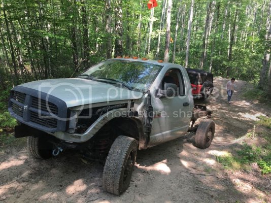

Took it out for a quick test ride at one of our local parks! Apart from debeading my right front tire, and shearing the center skid plate bolts, I had no carnage:
No flex zone:

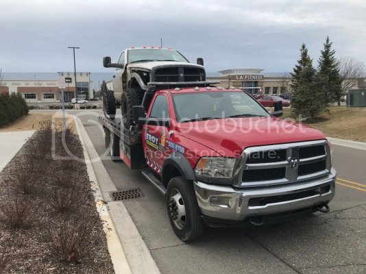

Had to get towed out of the rock pile. Tires suck and I'm way too low:
What I get for listening to my friends.... This is where my skid plate bolt went kaput.

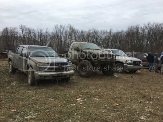

Looks like an RC car! Bonus JL Rubicon on the right too.
The truck has no flex (obviously), I had no ground clearance and the tires are definitely not meant for off roading. But it surprised me! I can't imagine what it'll do when my tires come in :)

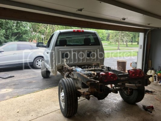

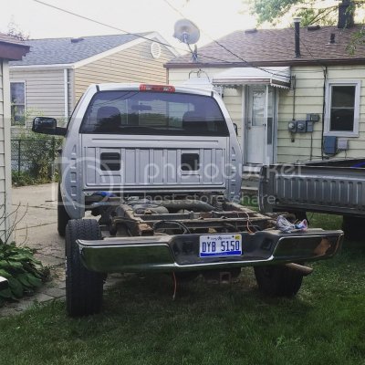

Not a lot of progress since the first two weeks but I moved the tail lights and rewired them:
"Let's play a game..."
Done! They look silly but have all the stock functionality so who cares:

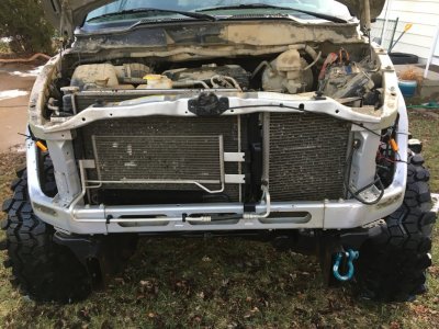

Forgot to add, I removed the headlights and added $20 LED lights from amazon. Simple mounting for now. I plan to get a welder and weld a flat bracket to the hydroform that will sit horizontal to the ground that I could mount a few more LED lights if I want. It uses the stock wiring so the headlight switch works.

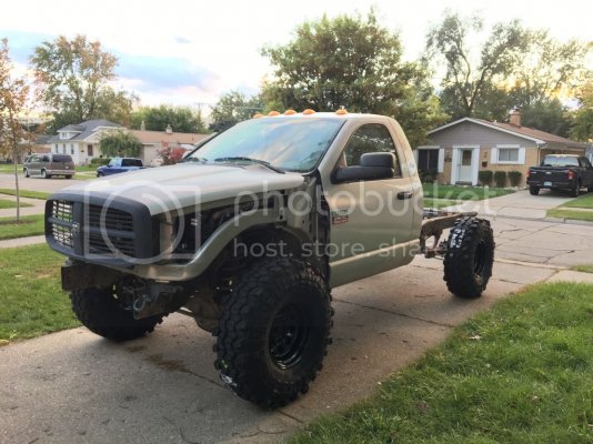

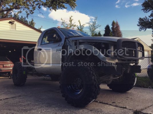

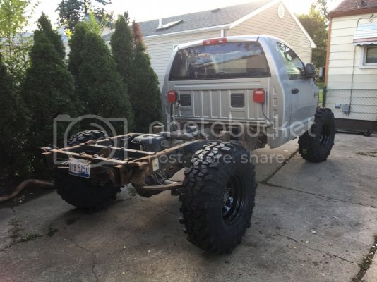

Switched from stock 31's to 40's!! Super Swamper SX2's. Rear end of a fox body for scale :D
The truck looks waaaay better now and should have more usable clearance on the rocks.

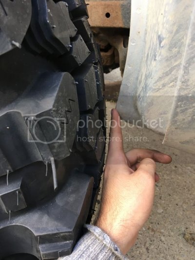

Thanks! I love the look of them! They rub like m'fers though.. I've cut the flange up 8" or so from the bottom but they still hit hard with any flex at all and minimal steering angle. I plan to really cut into the body this weekend to clear up some more space but long term I really need to push that axle forward. I don't really have the money to spend on tubing right now for longer control arms. Plus, pushing the axle forward may require me to redo my steering, shock/spring mounts, and eventually a drive shaft. This is how it starts right? haha..

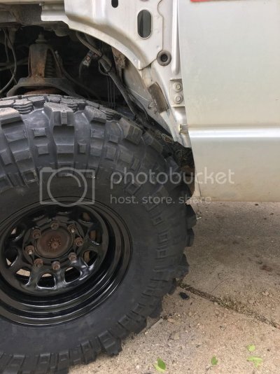

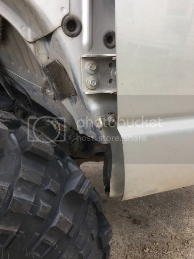

So I've driven the truck around town a few times and man does it rub. Just rolling off my side walk barely turning the wheels I rub bad. So I got to work doing some cutting. Definitely better now since I can lock the wheel on either side without rubbing but I'll need to check when I get it flexed out. After pics:
Full lock:
Full lock on the other side:

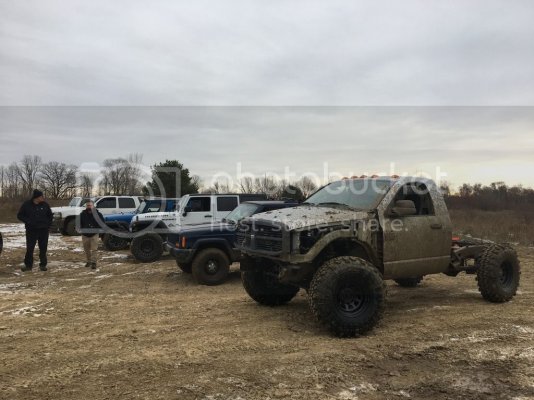

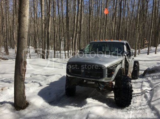

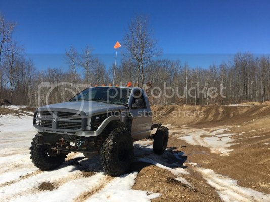

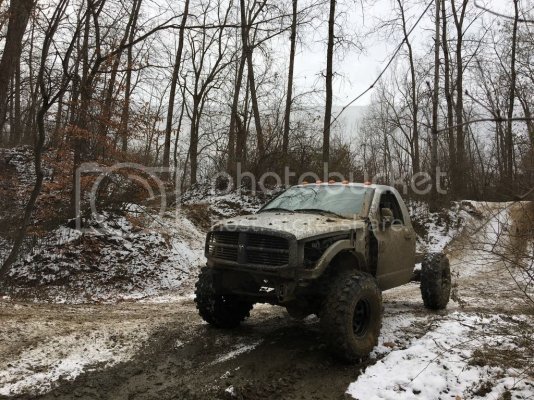

I ended up going to Thanksgiving at the Mounds in 2018. The Mounds is a nice little park that has some rock obstacles but mostly cool tight trails. Some of the trails are pretty tight for the ol' long bed but she maneuvers pretty well! It helps that I can turn around and see exactly where each rear tire is during the tight sections.
Poser shot. You can't see it here but this was right after some pretty tight trails. The leader almost led us into a side by side trail that would have really f'd us full size guys.
Another poser shot

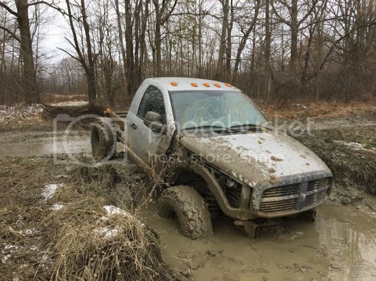

I got stuck here when I bottomed out. This thing never had any problems chugging through the mud, but the wheelbase is my limiting factor
Lookin' pretty much stock... :D
The tires really transformed this thing off road. I still don't have a lot of flex even with 2 leaves removed, but the grip and the extra clearance from the tires made this thing just walk through the mud with no problems. The only issues I ran into were from my long wheelbase or the fact that my airbox is completely open on the right side which would let mud in easy and I didn't want to mess up the engine. Snorkel and shortened wheelbase is on the list!

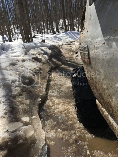

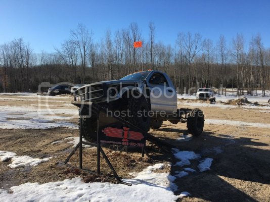

So after that trip, I went to another even up here called reject run! -15 degrees F, lots of snow, a night run, and some nice trails made this a great experience. From the night before heading out finding out my TIPM fuel pump relay went bad, doing some last minute sketchy wiring in the freezing snowy weather on my fuel pump, an annoying seat belt alarm that wouldn't turn off, losing my phone in the snow for 2 hours, an almost-destroyed chassis inline connector and -15 degree weather, I had a great time at Reject Run! Great friends and great adventures make anytime a good time!
All cleaned up before heading out:
Following coworkers in a stock WJ. This guy ended up jacking up his right side rocker on a chunk of ice :D
In cab view looking backwards:
I don't have a lot of pictures or videos of actually wheeling but here's a pic of the carnage. Truth is this was completely my fault since I didn't protect my inline connector.. A bunch of lights came on but she was still driveable. She did the 2.5 hour 140 mile drive home no problem :D
I'm pretty bad about taking pictures when Im out on trails since it's not really a priority but I do like to have some for the memories.

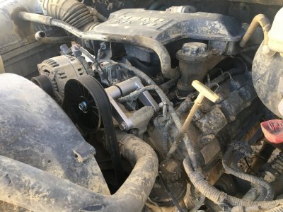

So I got my AC delete pulley in the mail and installed that. Then I've been going through and cutting off excess wires for things I don't want or need. So far I've taken out the front turn signal wiring, impact sensor wiring (which didn't even have a sensor connected anyway), both TPMS sensor antennas and the AC compressor wiring. With the AC system out, I have a ton of space in behind the grill. I plan to keep the fan and shroud and I may use it later for cooling some accessory. Here are a few pictures of the process.

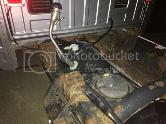

1. I believe the misfires were caused by low/bad fuel. As I was driving back from the last wheeling trip, I suspect the fuel got very low (since my gas gauge wasn't working) and must have picked up a bunch of crap at the bottom of the tank. I added another 5 gallons and some fuel injector cleaner and ran it for a 20 minutes and now the codes are gone. I took the time to replace the spark plugs which were definitely worn. 0.061"+ gap to a spec of 0.044"! so that should help it run better. Also got a new air filter and removed the air box snorkel.
2. Removed the rear interior panel, seats, and carpet. Much to my dismay, my front driver side floor board is rusting through :(. But at least it's a good chance to learn how to weld in body panels! This truck isn't a show vehicle by any means so I'd rather learn on something that's already ugly anyway. The rest of the interior looked relatively solid. One step closer to hitting my target weight :D

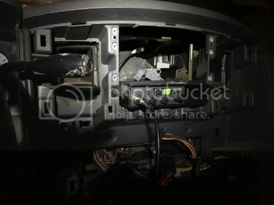

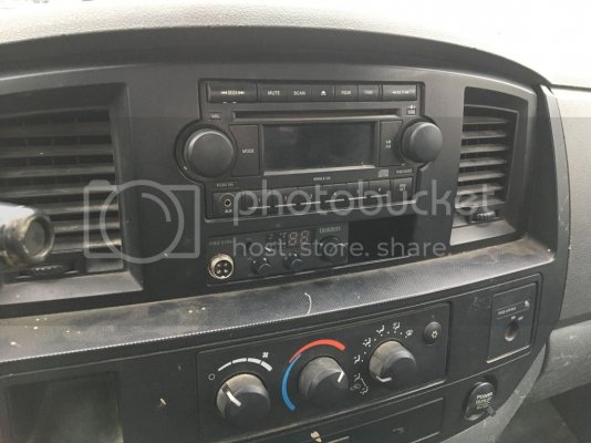

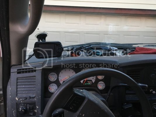

3. I installed my CB radio, a Uniden 510XL. Very cheap and supposed to be very durable. Located it in that cubby under the radio. I still haven't decided where I want the antenna to be mounted.. I go back and forth between the rear of the cab or the front in the cowl or next to the stock radio antenna location. We'll see what I decide. I had to cut in to the IP cross brace since the antenna cable was crashing into it. While I had my dash taken apart, I taped up some of the warning lights since they were annoying and pretty sure I jacked up the speedometer. I was trying to reposition the needle and now it sits way lower than before after I heard a "snap". So that's cool...
CB Radio:
Cluster:

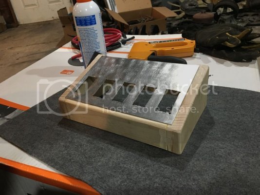

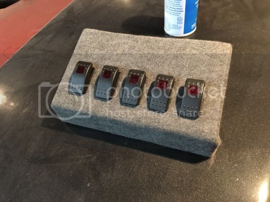

4. Since I hated my quick and dirty fuel pump wiring, I went ahead and made a switch panel with 5 auxiliary switches. Current plan is to have 1. Fuel pump 2. Second set of lights 3. Rock lights 4. Engine fan 5. CB radio, probably not in that order. The fuse panel is all wired in and mounted, just need to wire in my new electrical items! The switch panel actually came out better than I expected. It looks out of place in the rest of the stripped interior, but I'll make a whole console later on. The last thing I need is to add my 100 amp inline fuse to protect the fuse box, temporarily mount it to the body and I'll be set!
Fuse box, 6 gauge cables to the battery, convolute around the cables for protection. Any future auxiliary stuff will go through this central box.
Switch panel being made:
I don't have anything above the switches currently, but may eventually put in a USB charger or a battery volt meter. Not sure yet, that will be something in the future.

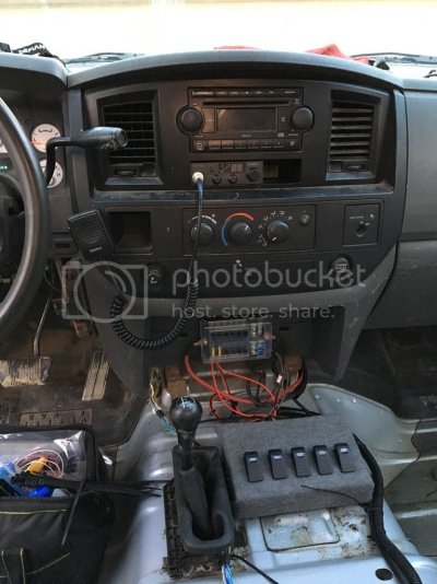

1. Wired in my CB radio and fuel pump to the switch panel now. The panel is mounted to the body with velcro and looks very out of place. I didn't hard mount it since I don't know where exactly I want it but need to keep it from moving around to much. Eventually I'll have a whole center console so somehow I'll have to fit it in later.
Finished in the dark:
The CB on. Since I have it wired through my switch panel, I can use the CB even if I don't have the ignition on which may be handy. This does present the problem of leaving it on and draining the battery, but the switches have LEDs that are hooked up so it shouldn't be a problem for me to notice. We'll see!
2. I wrapped the wires in convolute to protect it. The convolute is a bit oversized so I can add more wires inside if I need to. I really hate having loose wires everywhere so I wanted to make sure it looked good. I also used some zip-tie with christmas tree clips to hold the convolute in place. It looks better than any wiring I've done before, but I'll be redoing it so the convolute is routed nicer. Idk why I'm so picky with wiring...
Christmas tree zip ties in place:
Interior shot with my CB antenna and the other wiring routed and secured:

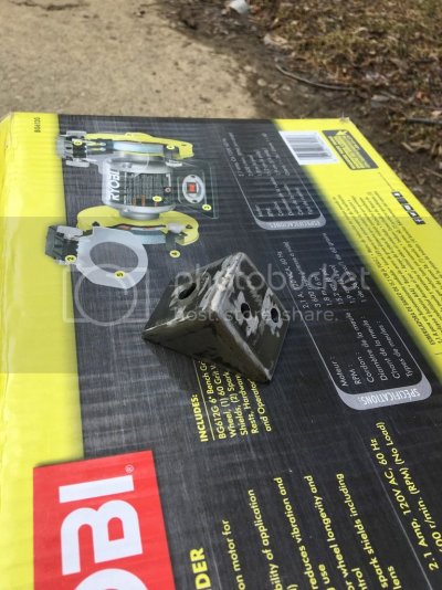

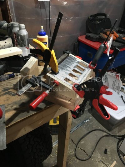

3. I made a simple CB radio mount and painted it silver! This is the first welding project I've done so of course there was a lot of grinding to get the welds smooth but I think it turned out ok. I was impatient and mounted it before the paint dried so there are some gouges in the paint. I'll be going back to redo that as well.. But, I'm pleased with it overall. Last thing to do will be to add the antenna ground which will probably just go to one of the mount bolts.
Before paint:
After paint!
Mounted and with convolute clipped in place:

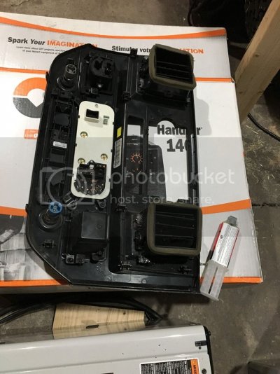

4. Not really an interesting mod but I glued the vents back on the IP since they were loose. After those were dry I reinstalled the IP and attached my CB radio speaker. I had to resist the urge to cut off all the loose wires behind the IP but figured I could keep them for later in case I ever wanted an ignition power source or something, we'll see. For now, the IP is back together
Glued together:

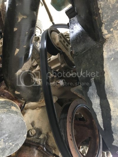

1. Tuesday when I went to start the truck up to make sure I didn't have problems, I found out my misfire had not gone away. Turns out when the misfire stopped the last time, it was because the ECU was going into closed loop fueling instead of open loop. So essentially, there was some huge fueling error and without the O2 feedback my ECU wasn't able to adequately adjust for it. As soon as it warmed up enough, the O2 sensor sent fueling corrections and my misfire was gone. Knowing this information, I decided to pull off the fuel rail and injectors and clean them. For cleaning greasy, grimy things like this, I use pine sol mixed with water. It's very soft on all materials, but will make the grease just fall with a light brushing. I blew the rails and injectors out with compressed air and then threw her back together. When I fired her up, she didn't have the crazy misfire like before so I think that did the trick! I still think the main cause was crap in fuel system and it seems like it's mostly cleared out now. 2 out of the last 3 off road trips I've had to make fixes on my fuel system last minute! It's a trend now I guess...

New pictures of my truck flexing. Biggest difference from the first time is the wheels and removal of the overload spring and 3rd largest spring in the back. Still way to stiff! I have some springs from a friend I'm going to try in the front which will make it a lot softer.
View from in the cab:
This blue Jeep made it up the only hill I couldn't go up. I did manage to go up the hill on either side of it in reverse though haha :D.
Some poser shots:
Random shots. These tires love mud and water. I just idle through it without any issue at all. Def the best purchase so far!
So, I managed to make it all the way to the park, wheel all day and the drive the 160 miles back home without a single issue!
... Until the next morning when my idler pulley flew off and then a fuel line popped. 300+ miles of driving and not a single issue, but 5 miles to the gym and I break down. Oh well, at least it was covered with AAA. Tow mirrors out!! By the way, this ramp truck was awesome. I'd love to have one to haul my rig with!
So now she's all taken apart in the front and I'm waiting until tomorrow for some better weather. I have a replacement water pump, idler pulley, front tie rods and ends. While under the truck, I got a good look at my jacked up right side motor mount with a destroyed bushing. That and a missing exhaust manifold bolt.. Don't mind the rust, it's a Michigan thing :rolleyes:
