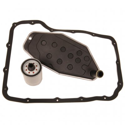

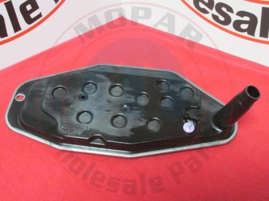

Mag HyTec pan
Redline C+ or AMSOIL
New Wix Filter kit
I dont have the info to why, but on the oem there is something on the filter that the wix doesnt have, so I usually say get the oem sump filter, you can see the two. I don't know if that is a safty valve or useless piece of plastic, but why put it there if it has no reason? First pic oem, 2nd is wix.
DILLIGAF
May 28, 2016
4,378
8,023
Canada
Its Dodge so im willing to bet its useless... lol...
I do my trans oil change every 2 years and I used that wix kit the last 4 times.
