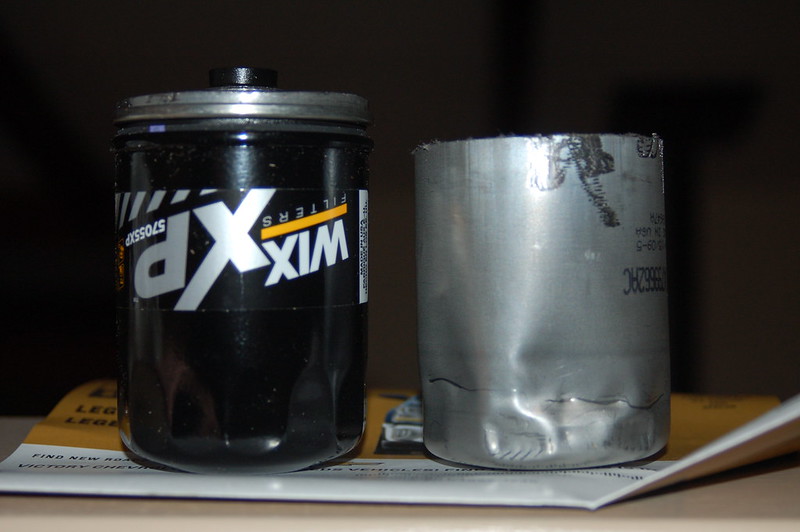

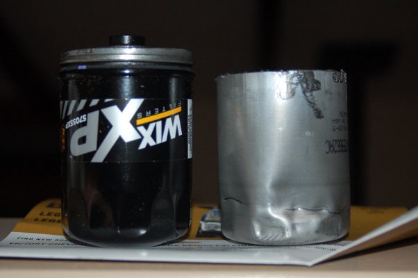

WIX 57055XP
RP 10-2867
M1-110A (synthetic blend)
XG7317
EA15K13 amsoil

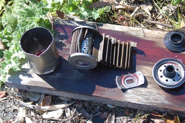

All appear to be replacements for the oem garbage paper filter for all the rfe's, 5 speed and 6 speed, I believe this option will be for any older rams with same thread size of course not the 8 speeds. These paper filters get stiff and are worthless, but the synthetic media will filter as long as you need it. There also is a metal thread option instead of plastic, which you will need because you cannot re-use the plastic ones. Thanks to the many ram members who put this together. The Sump filters are already synthetic, and actually pretty well made, likely not even needed to replace for at least 100k miles.

If you opt for this filter package, you should consider a wire wheel to knock the paint off before installing.
Also, spring pressure if different on the xp, but most the other filters are the same leaf style as oem.
