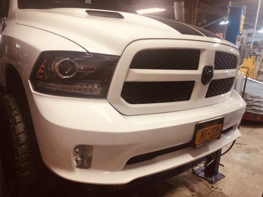

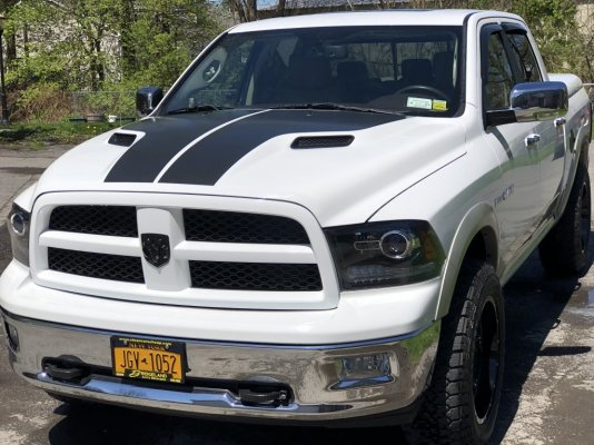

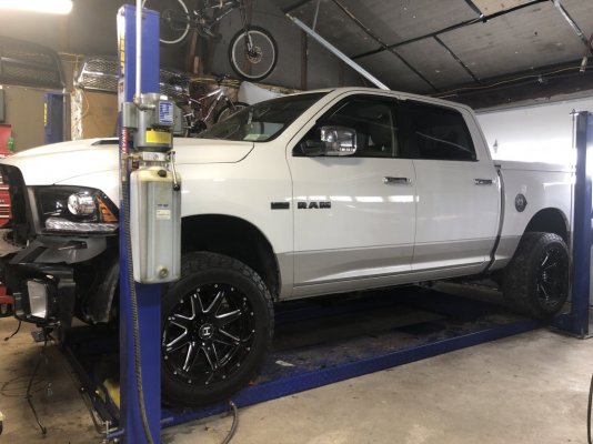

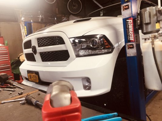

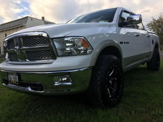

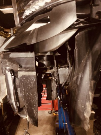

I pulled the trigger on a 2014 one pice bumper from 2014 Dodge Ram express, from a local guy that had it for sale, including all the pieces necessary to make the swap from my 2010 Ram laremie chrome 2 pice bumper. Just a slight modification on the plastic brackets under the headlights, slightly different . My truck wasn’t equipped with a mounting hole, one one end , I had to add a spacer to make fit. Other than that, everything for better then I expected. I also got me a grill on the marketplace because the bottom corners are different34608B74-2F72-45DE-A071-947B68D849BE.jpeg83658C05-FF42-4EE9-9364-C145C8F4A848.jpeg667BDE37-EEA7-4A00-B79E-C549E667607E.jpeg712ED83A-4A15-4C62-8552-A14514FD9858.jpeg4C71C546-FC1B-40B4-915D-7E6F564334DC.jpegA7F4C330-CCA9-492A-85A1-A489966B3F19.jpegA7F4C330-CCA9-492A-85A1-A489966B3F19.jpeg5A49B531-9BE3-404D-84E3-D18A9AFE1FF0.jpeg on the newer years.
