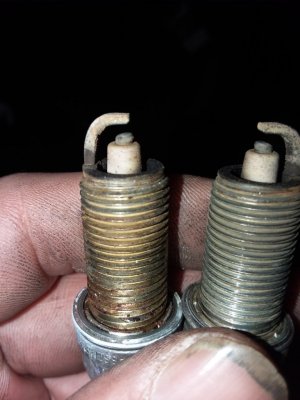

Well the spark plugs were bad. So I guess I'm gonna have to go ahead and change all of them I'm sure the rest wont be far behind. It's back to running good again. And the code for the number 4 cylinder deactivation also went away with changing the plugs in the number 2 cylinder
