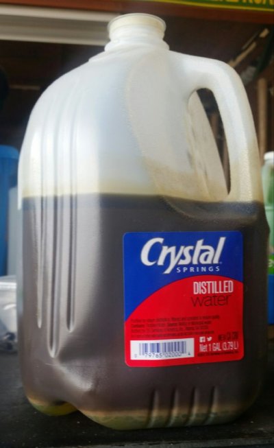

You can even just change the oil, and put the old oil into a couple jugs. Once it settles, you will see.
Notice the layers: Coolant at bottom, milkshake middle, small oil layer at top.
This was from our '02 1500 4.7L
