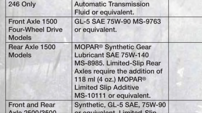

Do both of the differentials (front & back) require fluid? My guess is that they both do, but I'm not sure. I know I have a transfer case that requires fluid.
The owner's manual says: "Front Axle 1500 Four-Wheel Drive Models" in the list of fluid specs. It doesn't say: Front Axle & Rear Axle Four...
How often should these fluids be changed? I bought her new in 2011 & she has 44K miles; I haven't yet changed these fluids, but thought I would in the New Year along with changing the original plugs.

Both require fluid, here you go for reference.
I’ll try and find you change intervals and capacities in a bit.

^^^^^ This----Do you know if you have a limited slip rear diff?

Thank you both very much. Rear slip differential? & to think, I just found out that I have 16 spark plugs! Jay, how would I find out? I will look on original invoice & if that doesn't know, I'll Google the VIN & see if that provides the info.
