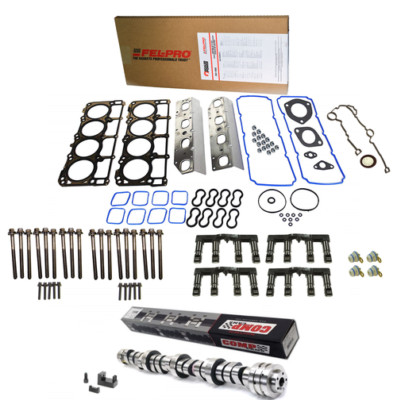

PS, Im looking at this kit, in a stage 3 cam
Plus adding a melling high volume . more pressure oil pump
Im on a little bit of a budget and I need to get my truck back in service.
So am thinking do the cam swap . MDS delete and live with the ck engine light on for a bit
Then later have the PCMs MDS disabled
Thoughts

If you change to a HV pump,install the stock bypass spring out of your oriiginal pump. If you want,you could install a washer under the spring to bump up the bypass pressure slightly.
Honestly if you bump the idle rpm to 750 rpm,you'll have basically the same oil pressure as the hv volume pump creates at 600 rpm,and the hv pump isn't really an upgrade at that point.

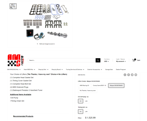

This one for example comes with a tuner
Ive talked to a AMS rep and all the tech support staff is out , sounds like due to storm aftermath
But, looks like $1525 plus tax for everything including Mopar brand lifters
But he says this kit comes with a tuner to turn the MDS off and makes some minor tweaks so to speak , A Tow tune, Perf tune , tire change speedometer calibrations etc etc
But said tuner is Vin matched to the truck once used , which I dont have an issue with
And like you guys mentioned if I was to upgrade to anything but stock 5.7 non MDS cam, an outside source custom tune is required , as well as valve springs recommended.
