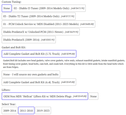

I’d recommend THIS kit from Moe’s. You can add the lifters and whatever else you want under the cam selection.
Thank you.
It would be nice to tune it with the product of the link you told me,
I didn't have enough money to spare, so I found a kit similar to pure.
I want to work with the product in this link.
In addition, I think you only need to add water pumps and chain-related accessories.
Is it perfect?

If you’re gonna get the MMX kit, I’d get it straight from MMX as it includes the timing set and gaskets. HERE’S the link to it on MMX’s website. Full kit comes out to around $1600
It seems that a few gaskets and seals have been excluded from the new link.
I think it would be better to add more timing parts from the existing link.
Thank you for the information.
