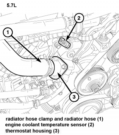

If you go to a parts store they can do a scan and tell you what your vehicle's temp is. You can also ohm out the contacts on the sensor with a cheap multimeter, and compare to an ohm/temp chart for Dodge Rams (just google it). Check cold, then warm to and compare to ambient temps, and whatever the temp is on the upper hose water neck (engine-side) ...using an IR temp gun (pointing at #3 below).
Could also be the thermostat (fairly common).
Usually water pumps begin to leak before they fail. You could look up ...from underneath, and see if you see any coolant coming out of the weep-hole on the bottom-side of the water pump. If it's dry, I wouldn't condemn it w/o checking the other items.
