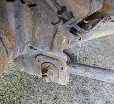

Drift normally is a alignment or tire issue. I would assume it's a alignment issue and the castor needs adjusted.
I set my truck up with thuren specs regardless of leveled or not and have had good success on 2 trucks now. https://www.thurenfabrication.com/pages/2010-2013-2500-alignment
Take a picture of where your cam bolts are.

Castor looks spot on. Would be looking at track bar and control arm bushings especially if they are factory being a 12.
Replaced all bushings on my 11 but I do still have a metallic thud or feel in my steering as well. I sourced it to being the steering shaft where the 2 slide together having some slope. Have heard of some taking it a part and greasing just haven't personally but may be a decent suggestion on it. Did put the emf steering joint bushing in the shaft section that's under the dash just before the firewall that helped a lot as they tend to woler out quite a bit.

If you still have problems check out Geno’s Garage they have a kit for the steering shaft that’ll fix the slop caused by the rubber bushings that Ram decided to use.

This has all the symptoms of a worn or loose track bar. If the bushings are shot or the bolts are loose, the axle can actually move and cause the thump you are hearing in addition to the poor steering. If you remove the track bar for inspection, the torque on the bolts is 200 ft. lb. when re-installing.
