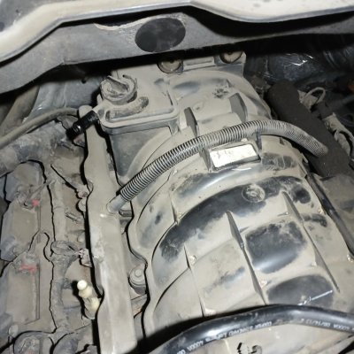

I am trying to remove my intake to replace the engine oil cooler, I don't know what the tube is going across it or how to remove it. Any help would be apprecieated.

Thats the fuel line connecting both of the fuel rails together. Leave the rails attached unless you want to remove all of the injectors.
There should be a quick connect style fuel connector at the driver side rear of the fuel rail.
The fact that you don't know this kinda makes me worried about you working on this. This is standard stuff

I agree with G.i don't think you know what you're doing,as there's "no" oil cooler under the intake.You're 14 doesn't have any oil cooler on the engine.The only things under the intake on a 5.7 are the MDS solenoids and the VVT solenoid.

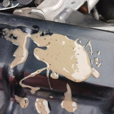

My radiator busted, temp gauge pegged out light came on i shut it down as fast as i could. Ive already got the radiator out 253+ miles Sludge.jpg

I'd still do what I recommended above. A picture of some milky oil really isn't going to tell us much.

You can pick up a test kit at a parts store to check for combustion gasses in the coolant system. It looks like you blew a head gasket.
Assuming you posted that pic in response to my question in post#6, the pic confirms oil in the coolant. It does indeed tell us something. It probably didn't get there via teleportation.

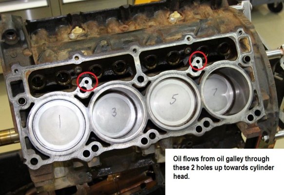

Oil pressure is 50+ psi and the cooling system pressure is about 16-20psi when hot.
Pressurized oil flows up through passages from the block, up into the head and to the rocker arm assembly, going through the head gasket.
When the head warps due to overheating, the high pressure oil flowing up through these two passages tend overpower the cooling system pressure, to make its way into the nearby coolant passages.
At the head gasket, the oil flows into the bolt hole, where it is forced up to the rockers. The high pressure oil in the bolt hole and coolant passages are very close to each other, and the oil pressure is higher, so the cross contamination tends to be more, oil into the cooling system than the other way around. But, can go both ways, depending on which part of the gasket is leaking.
