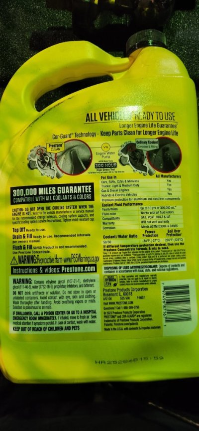

There is "universal" antifreeze thats compatible. I flushed mine last year and used prestone universal coolant and it is green as well. I did the flush myself so I was able to take my time and flush it completely to get all of the original coolant out and started fresh with the universal prestone. After I flushed and refilled it I drove it for a week and rechecked the coolant to make sure its still green and not some blended off color which would indicate that I still had some original coolant in it. It is still bright green so I know its good.
I doubt you would've had any problems that quickly unless there was already an existing issue.
This is what I used
