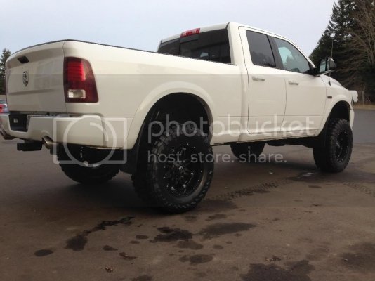

SICK!!
What gears do you have?
Very nice.. What is the wheel size/offset? I'm looking to end up with 6" RCX, bilsteins at 2.8, and 3" body lift and am trying to see if I can fit 40s
Ok, mine are 20x10 -24mm... Based on your experience of your setup, what do you think about any fitment issues with mine?
I think it should work if you get a narrower 40". My buddy had 40x13.50 ProComp XTerrains. I don't think a 40x15.50 would work without some serious cutting
Since people seem to ask a lot the fenders are frt 48.5 and rear 49.5. Instead of the 15.50s you could try the Swamper M16s. They're 14.50s or the 39.5x13.50 Iroks
