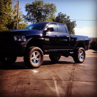

I have 37x13.50 with stock 20s now. Anyone know if I would be able to go 38s with a 20x12 or x14 with no problem? I'm not sure what will be effected by putting a deeper wheel

I don't think you will fit 38's with a wheel that wide. Wheel width and backspacing are as important to fitment as lift height and tire size.

Im running the same lift on 20x12 moto metals with 35" tires. Without the body lift they rubbed to bad to even do some trimming and call it good. I would be worried about 37" tires on my rims let alone 38's
