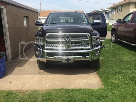

Hey just wondering if any one has installed a light bar inside the bumper at least flush, and what they used for mounting or any ideas
I have a 20" to put in and I have seen the mounts that sit the light bar out infront, but would like mine inside
Thanks

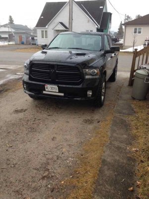

Ive got mine down there recessed, real easy to do on sports snd express models, cut filler panel to fit light, behind the bumper the support brackets line up perfectly with mounts on 20" bars
If you search theres a couple posts where i have better pics but this is the only one i have on my phone

didn't you need to raise and red rill new holes for your license plate bracket? otherwise it blocks the middle section of the top row of leds. at least thats how i measured it. i wouldn't even mind it if it was mounted a little farther out and we could get a full 40" bar comfortably installed. i just need someone to make brackets...any takers?

looks like he just flipped the bracket upside down
Ya i just flipped it

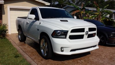

I put a 25" single row in mine.. Made some brackets using an old tv mount, not to much back there to hold onto. I'll crawl underneath and take a pic when I get a chance, and by that I mean when I'm not feeling lazy..
thats clean! where in south florida are you?
