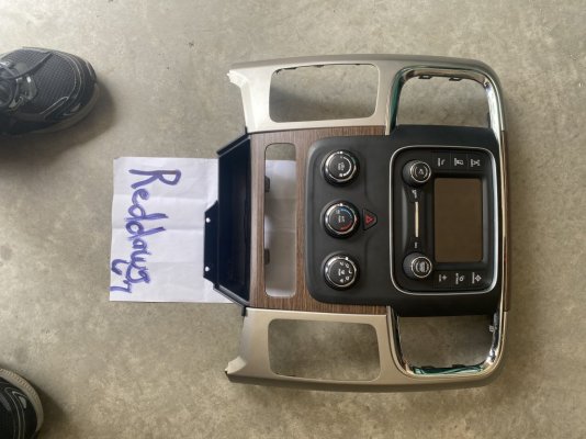

I have an ra2 for sale and the bezel if you need it (will do a good deal )Your hub in the center console should work You can get everything else from @Mpgrimm2 to make it work .reverse camera harness and mics and harness .The ra2 looks the same as the ra1 it just has the Bluetooth and hands free ability if you have the steering wheel buttons .Also if you go the eBay route be sure your getting oem parts not the cheap china stuff ( it will save you a lot of grief )
