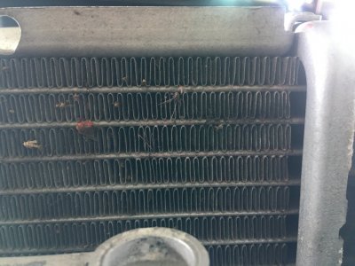

After looking for days I found the radiator to be the problem. 5 days to get a new one under warranty.
Standing facing the radiator I removed the panel push retainer with my right hand and pulled the top cover back in order to get a better look. On the driver side corner the radiator was wet. Their was never a wet spot on the ground or wet anywhere else.
This is my first post, I hope that it may help others. With all the noise about the water pump I really figured it to be the problem,but not so in my case. IMG_1741.jpg
