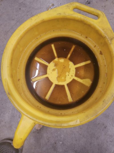

At 140k miles and no previous coolant service, we drained the reservoir. What little fluid it had left looked pretty crappy.20260314_195626.jpg
What came out with the radiator was not any better:

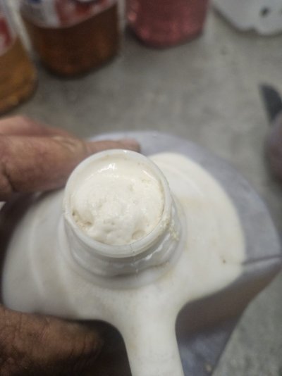

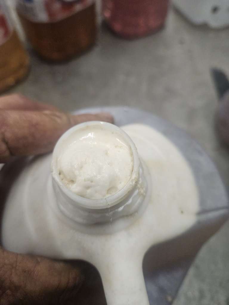

I put my gutless thermostat in and filled her up with distilled water, and when we ran it for 30 seconds or so the clean water turned brownish very fast and developed a white froth quickly.
Several drain and fills later, it was a little lighter, but still crappy. So, finally we took the top hose off the rad and i plugged the hose neck with my hand, filled the radiator with clean water half-full into my coolant funnel and ran the engine for 15-20 seconds with a couple revs to push the dingy coolant from the top hose into our collection pan.
After a few rounds of this, it was getting clearer, but still had the white froth. It smelled like coolant and was not oily as far as I could tell.

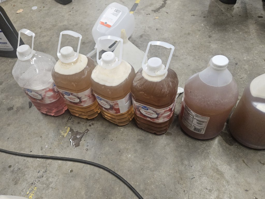

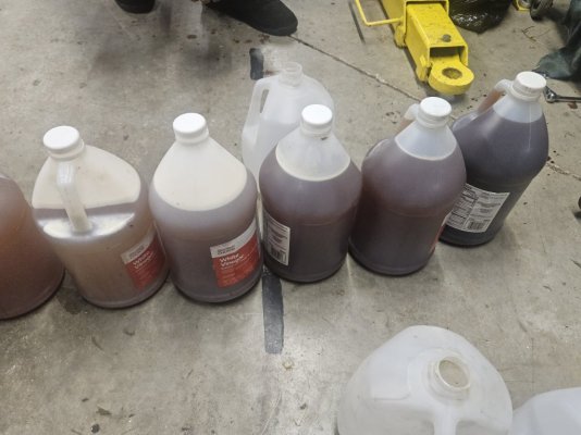

Here's the progression of very dirty to still a little dirty, but good enough for this go-round.
From dirtiest on right to good enough for now on the left:20260315_011322.jpg20260315_011327.jpg
It has to be 50 times better than it was before.

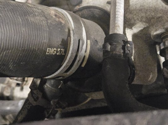

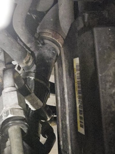

Hey Rick, I got a chance to look at the coolant hose connections on the '18 Laramie, at least the ones at the thermostat and lower radiator hose.
Turns out, there's a short piece of hose at the lower radiator outlet, and then a short pipe with 2 small hose ports, and then another hose going to the water pump inlet.
There's also a hose that taps off the thermostat housing:
I did not get a chance to check out the trans heat exchanger routing, though.

The easiest way to delete them would be a new thermostat housing for an earlier truck,then cut the 1 hose leading to the transmission heater and plug it with a bolt that's in the lower rad hose,you could also cut and plug the hose off the thermostat housing with a bolt,but that'd look totally redneck,lol .Those dedicated hose clamp pliars are a lifesaver when it comes to working with spring clamps,beats the hell out of using normal pliars :Big Laugh:

I didn't get a chance to see just what went where with those hose routings.
I wonder if you could order a set of heater core hoses like i did for my '15, along with a lower rad hose, and a standard thermostat housing???

That'd be the proper way to get rid of them Ed.
