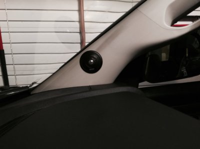

My tweeters fit fine in the a-pillars. Not sure what the deal is with everyone using the Sail panels.

You mean with out modification, no pods?
Can you post pics?

They sit perfectly flush! Granted you don't want to go too big.

The following tweeters that I know sit flush and fit just fine are as follows
ScanSpeak Illuminators D and Ring version
Morel MT250, 230 23 and 22
Alpine SPX 17Pro Tweeters
A/D/S PX Concept.2
SEAS Prestige 27TFFNC/G
LPG 26NA
Vifa XT25SC90-04
Hertz ML 280
Rainbow lines Cal 27, 26 etc.. The 28 is too deep.
The depth of the tweeters shouldn't be more than 22-25mm.
