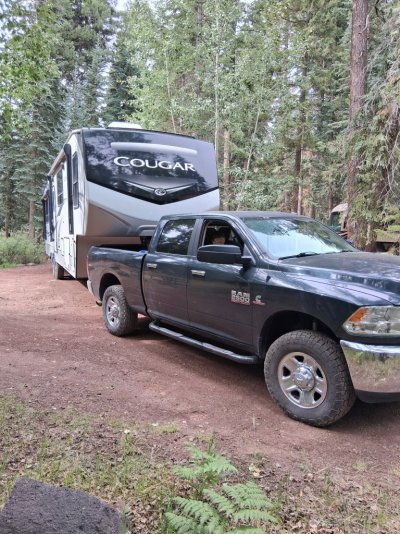

If you don't mind me asking, what is the hitch weight of your fifth wheel and the payload of your truck?
