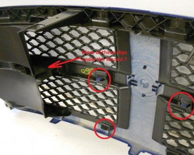

In the picture below, the clips I am concerned with are the small black ones that appear to hold the shrouding around the grille insert area. (red arrow)
Does that whole shrouding piece have to come off to get to more hidden clips to get the inserts out ? Am I over thinking it?
I'm just really particular about my stuff and I dont want to break anything. I have the upper grille support off (8mm bolts) I just want to swap my Big Horn / Sport inserts into the Express grille surround to go body color.
Thanks.

Here's a better picture. I see the clips that are blue on the express grille, chrome on the BH grille of course .. but my question is are there more of these blue / chrome larger clips under the shrouding?

...but my question is are there more of these blue / chrome larger clips under the shrouding?
Yes - there are more clips under both shrouds...after you remove the 8 mm bolts, those two shrouds un-clip relatively easily (plastic clips), and then you can literally go left to right and pop loose the clips your red arrow is pointing to with a flat head screwdriver...
Another thing - I have no real idea what those shrouds actually do...I put mine back after replacing my grille inserts, but they appear to be fairly useless and actually block a lot of air from coming into the grille...
It took me about an hour and a half total to replace my inserts...

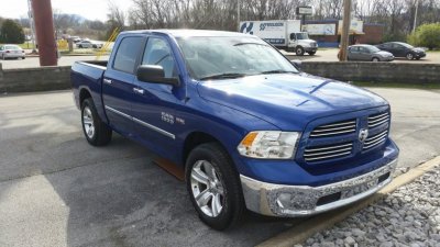

Got it replaced and I am really liking the difference. Dont get me wrong, the Laramie / Big Horn grille looks good too but in my opinion its a little too much chrome. I like the Express trucks too but on the Blue Streak Color it's just too much blue .. again, just me.
The truck was a bit dirty in the pic, I'll post a better one in a little bit. .. I think it looks a little more subtle and clean.

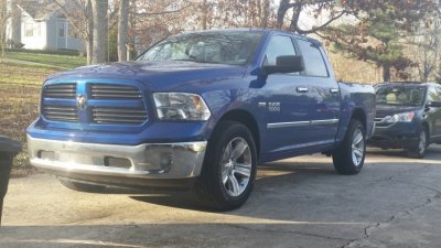

Here's a little better picture of it cleaned up. Im really liking it. I think the chrome inserts add just enough to tie in the bumper, a little chrome in the grille emblem too.
Just not so much bling .. but it looks a little sportier too (no pun intended)
You guys know what I mean by the truck looking more 'RAM'ish' than 'Dodge'ish' ?
