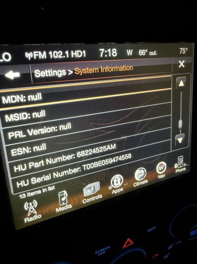

I have a 2014 Ram and would like to move the backup camera from my mirror to the 8.4" radio. I looked at a couple kits, but they require a certain software version, and I am running a newer version than those kits can handle. Does anyone else have a way to do this?

What you can do will depend on:
- if it's a 13-15 Harmon RAx series radio? (Radio part# ?),
- what SW version it's on (ie 17.11.x?)
- whether or not you have a backup cam AND cargo/bed cam to deal with?
Send me a message if you'd like to get more details sorted/get a harness.

I do have both cargo and backup cameras
Your 2014 Ra4 Nav radio on SW v17.43.x 'should' only be able to support/display one camera input (backup Cam or cargo cam, not both). So you likely have CargoCam on radio and Backup cam on rearview mirror.
If you want both to be able to show up on the radio, you first need a 2016+ 8.4 radio, and a camera ReRoute harness, plus move the existing cargo cam wires over to a different input pin set on the radio connector.
