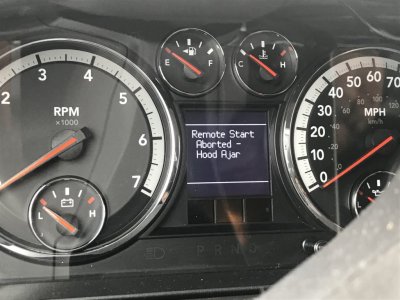

My remote starter is not working due to me trying to start my truck more than 2 times, they said it will not let you start the truck more than 2 times I don’t know why!! But now i get the message saying “remote Starter Aborted hood ajar” anyone know how to fix this problem? Hood is close like I said this happened after i try to start the truck more than twice in summer time when i had my dogs in the truck
Sounds to me like you have a connection problem. Check to make sure there is a good connection at the hood latch. Was it factory installed OEM or did someone else install?

Factory install, I tried to disconnect and connected again but I couldn’t get it out to be honest
Corrosion. You could try some CRC Electrical Contact cleaner. Disconnect the battery then hit the connector with it to let it soak in and try again. Either that or replace the hood latch and harness. Locate the install pdf for your year and read up on it.

Ghost_RAM thank you so much for the help, amazing to see people taking some time to help others, appreciate it, I replace the latch and is working fine again,
