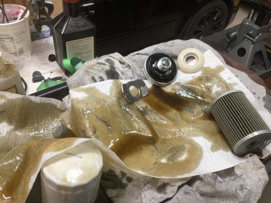

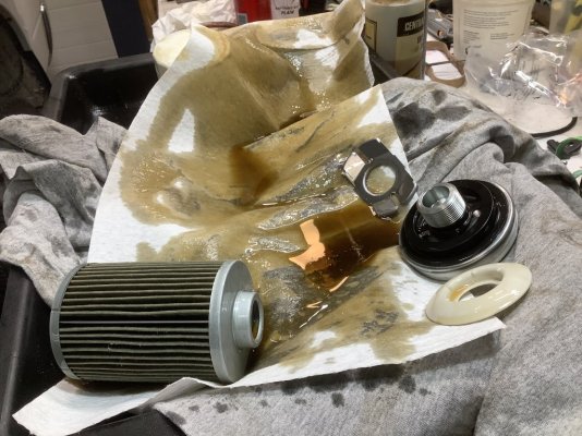

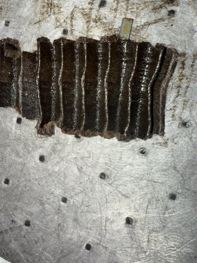

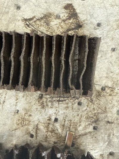

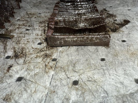

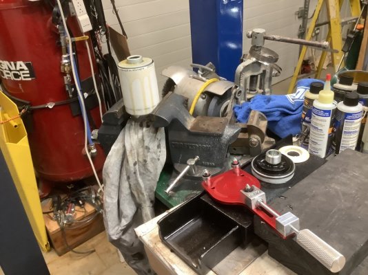

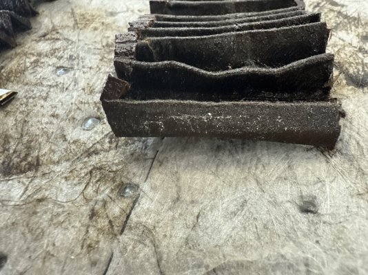

When I changed my timing chain and oil pump I did the first two at 100 miles each. After things in the oil filter looked better I even swapped out oil filters in between oil changes.Just me I guess,but the in between filter change is what I do in the rare case vacation time is going to overlap my normal 3k change. It means “minimum” cutting open and inspecting your filter.IMG_2532.jpegIMG_2294.jpegIMG_2295.jpegIMG_2293.jpegIMG_4351.jpeg

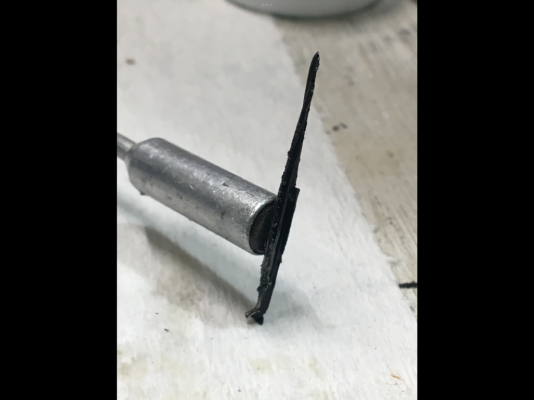

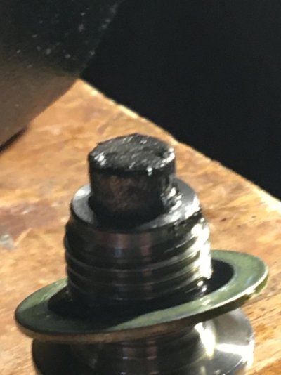

I pulled this out of my oil pan and smaller particles after I did the chain ,oil pump with pan off and cleaned. Lots of oil changes after I saw that.View attachment 561591
What in the holy he** is that item?
You could pull the intake manifold,it's pretty easy to remove,then check the screen on the VVT solenoid for metal.It's the solenoid at the front of the engine,the other 4 solenoids in the valley are the MDS solenoids.If the VVT screen is covered in metal fillings,the engine could be toast,not always,but Ma Mopar reconmends a new engine if the screen is full of shiny stuff.
I'd do that first,as the intake is easier to remove then the oil pan on a 4X4

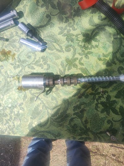

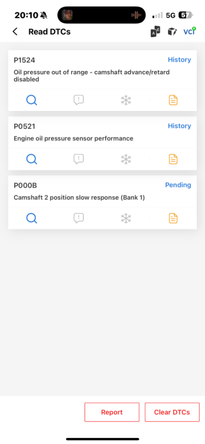

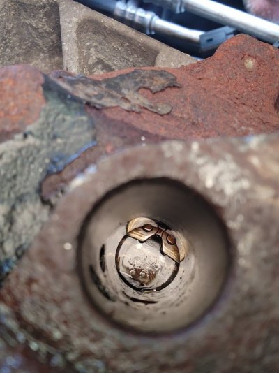

I tackled changing my VVT solenoid today. I also had planned to change my intake gaskets and port the intake while I had it all apart also.
I was having an intermittent check engine and the code was P000B.

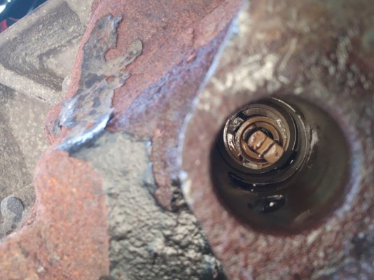

I did hit a snag with the solenoid while removing it, the old one broke in half or was already broke trying to pull it out. I was nearly ready to call it quit when I used a 3/8 cement wall anchor and simply turned it by finger into the remaining half of the solenoid and then gripped the bolt with a channel lock and tapped them with a hammer. Viola it came right out !
The last picture is what it looked like inside once it was removed. I'm wondering if anyone can give me some info as to what I'm looking at inside that void.
Also after finishing up the job my fuel consumption improved from 20.1L/100km to 15.3L/km
Idle and run oil pressure seemed to improve also as before my idle pressure was very low at 40-50 kpa, my new readings are 140-146 kpa idle and at 1500rpm it's in the 300 range kpa.
The truck also seems to shift and run smoother also now.
